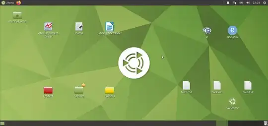

I'm using Ubuntu MATE 20.04 LTS. There are a lot carefully aligned icons on my desktop. Something like shown below:
icons
I can't find icon positions attributes in dconf / gsettings.
How can I backup their current positions to restore them later? Where such a file is located?
