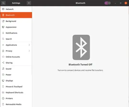

Bought a Bluetooth USB adapter from AliExpress, and trying to set up it on my Ubuntu machine. Could someone help with it? Ready to provide any logs, just let me know in comments.
NOTE: It's not a laptop, it's PC
I have typical symptoms:
  1. Plugged in adapter
  2. Open Bluetooth GUI menu
  3. Tried to turn on Bluetooth, but nothing happen
I already checked few answers on SO, but nothing helpful. Thanks in advance!

  5. hciconfig
    hci0: Type: Primary  Bus: USB
          BD Address: 00:1A:7D:DA:71:13  ACL MTU: 679:8  SCO MTU: 48:16
          DOWN
          RX bytes:367 acl:0 sco:0 events:12 errors:0
          TX bytes:37 acl:0 sco:0 commands:12 errors:0
  6. hciconfig -a hci0
            DOWN
            Features: 0xbf 0x3e 0x4d 0xfa 0xdb 0x3d 0x7b 0xc7
            Packet type: DM1 DM3 DM5 DH1 DH3 DH5 HV1 HV2 HV3
            Link policy:
            Link mode: SLAVE ACCEPT
As per official documentation, please post the output of (ref)
$ lsusb               *** You already did
$ hciconfig
$ hciconfig -a hci0   *** As this appears to be your bluetooth device
Plus, there are a few posts on issues with the device with the same Vendor ID/Device ID numbers as yours (0a12:0001).
  1. Bluetooth adapter configuration issue (ID 0a12:0001). Note the answers, which, aside from requiring you trying somewhat cumbersome procedures, they are encouraging as for the chances of you getting the dongle up and going. It is not worth reposting here the solutions, as they are in askubuntu.
  2. https://gist.github.com/nevack/6b36b82d715dc025163d9e9124840a07
  3. https://bbs.archlinux.org/viewtopic.php?id=257372
  4. https://www.insanelymac.com/forum/topic/320630-sierra-bluetooth-usb-dongle-0x0a120x0001-doesnt-work-cheap/ (info related to Mac, only perhaps useful)
Related
  1. https://ubuntuforums.org/showthread.php?t=1581539
  2. https://wiki.debian.org/HowToIdentifyADevice/USB
  3. https://stackoverflow.com/questions/43855812/is-there-a-way-to-find-out-which-bluetooth-device-is-plugged-into-which-usb-port
Diagnosis
Your output shows problems parsing /etc/bluetooth/main.conf for example this:
bluetoothd[16969]: src/main.c:parse_config() parsing /etc/bluetooth/main.conf
bluetoothd[16969]: src/main.c:parse_config() Key file does not have key “DiscoverableTimeout” in group “General”
bluetoothd[16969]: src/main.c:parse_config() Key file does not have key “AlwaysPairable” in group “General”
bluetoothd[16969]: src/main.c:parse_config() Key file does not have key “PairableTimeout” in group “General”
bluetoothd[16969]: src/main.c:parse_config() Key file does not have key “Privacy” in group “General”
bluetoothd[16969]: src/main.c:parse_config() Key file does not have key “JustWorksRepairing” in group “General”
bluetoothd[16969]: src/main.c:parse_config() Key file does not have key “TemporaryTimeout” in group “General”
bluetoothd[16969]: src/main.c:parse_config() Key file does not have key “Name” in group “General”
bluetoothd[16969]: src/main.c:parse_config() Key file does not have key “Class” in group “General”
bluetoothd[16969]: src/main.c:parse_config() Key file does not have key “DeviceID” in group “General”
bluetoothd[16969]: src/main.c:parse_config() Key file does not have key “ReverseServiceDiscovery” in group “General”
bluetoothd[16969]: src/main.c:parse_config() Key file does not have group “GATT”
Solution
