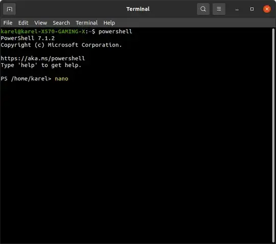

I tested launching nano from PowerShell running in Ubuntu 20.04 which was installed by sudo snap install powershell --classic and it worked as shown in the following screenshots.
enter image description here Launch nano from PowerShell running in Ubuntu.
nano opens in the same terminal window. PowerShell in still running in the background.
You can return to PowerShell from nano by pressing the keyboard combination Ctrl + X to exit from nano.
