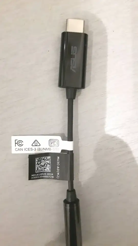

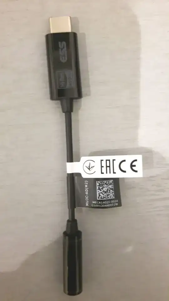

With the laptop internal speakers, no issue. Also, I tried with another headphones Bluetooth connected (not mine, I borrowed it), no issue. My headphones don't have Bluetooth, I can only connect it with the wire. But the thing is, the laptop does not have 3.5mm audio jack plug: there is a USB-C to jack adapter (furnished with the laptop, see images). So, I'm pretty sure the issue is with this adapter.
adapter_photo1
adapter_photo2
