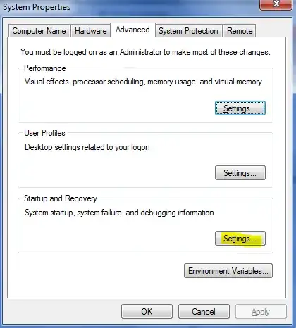

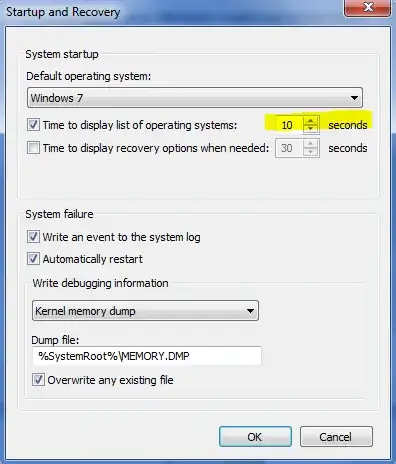

Right click on Computer, Properties, Advanced system settings, Startup& recovery settings, Time to display operating systems: Set it to 10.
System properties
Startup & Recovery settings
