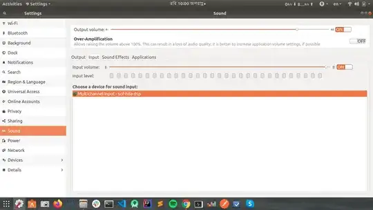

Headphone works properly but microphone is not working on my ubuntu 18.04. The input level bar doesn't change which indicates the microphone doesn't detect any sound.
Pulseeffect is installed on my laptop and i am not sure if the problem started after installing it. so uninstalled and restarted my pc but still sound input not working. Some help would be greatly appreciated, thanks.
