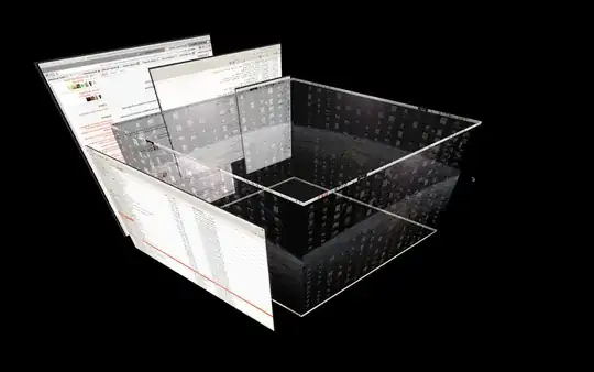

By setting others from the older ccsm, I got a rotating cube.
Alas, there are no more 3D windows
UPDATE: 3D windows are available for Gnome Classic. The Compiz PluginsExtra is required. Synaptic is required to install Compiz PluginsExtra, it is not available in Ubuntu Software Center. And they work very nicely!
