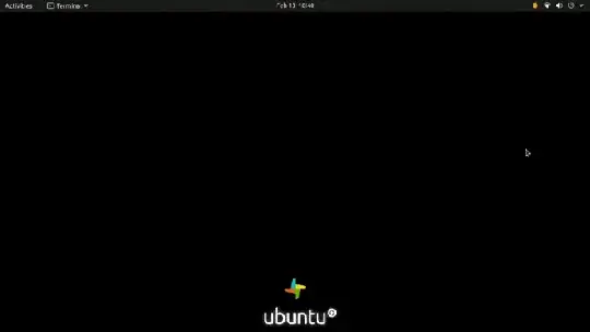

Will it be possible to change the default 20.04 Plymouth 3-curve spinner animation/rotation that is displayed during login with our own image ?
Update : As per instructions from the comment by UnKNOWn
Possible spinner replacement, 256x256px for ease of use
Added GIF

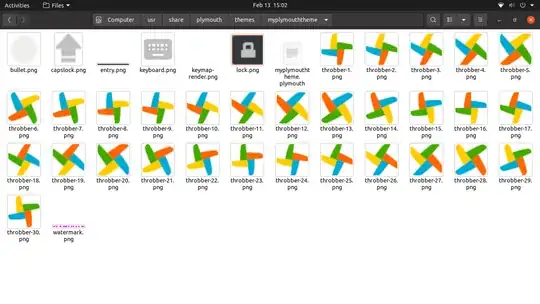

1. copy the spinner theme with below command
sudo cp -r /usr/share/plymouth/themes/spinner /usr/share/plymouth/themes/myplymouththeme
rename spinner.playmouth file to myplymouththeme.plymouth with below command
sudo mv /usr/share/plymouth/themes/myplymouththeme/spinner.plymouth /usr/share/plymouth/themes/myplymouththeme/myplymouththeme.plymouth
Open the file myplymouththeme.plymouth with below command and edit the contents as per your requirement.
sudo -H gedit /usr/share/plymouth/themes/myplymouththeme/myplymouththeme.plymouth
Some of the lines which needs to edit.. I have already edited.
ImageDir=/usr/share/plymouth/themes/myplymouththeme
HorizontalAlignment=.5 VerticalAlignment=.7 WatermarkHorizontalAlignment=.5 WatermarkVerticalAlignment=.96
Image directory is self explanative as we are going to keep our images in this.
HorAlignment .5 is center for the spinner.
VerAlignment .7 is from top of the screen towards bottom, you can reduce this to increase gap between watermark and spinner.
Watermarks are also similar to above explanation.
The image names seems to have throbber- prefix to its numbering like throbber-01.png throbber02.png etc.. Delete all the images with animation* and throbber* and then put your images in the said directory. seems it accepts only png files as Images.
Ok, configuration is done..

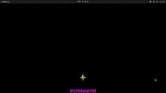

You can change the watermark.png with your preferred Image (keep a eye on default watermark.png pic size)
Reboot and See the Changes..

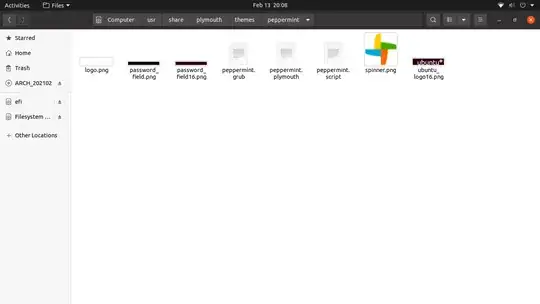

It seems tweaking an external script to your needs is easy. Here is the zip file https://github.com/PRATAP-KUMAR/LinkOnly/blob/main/peppermint.zip tweaked from https://www.cinnamon-look.org/p/1471802/
to use peppermint theme, keep the extracted directory peppermint in /usr/share/plymouth/themes/ then edit plymouthd.conf file.
sudo -H gedit /etc/plymouth/plymouthd.conf
with below content..
[Daemon]
Theme=peppermint
ShowDelay=0
Reboot..
Tweaking few things in this peppermint.script may reach your requirements.
