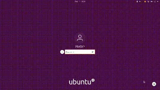

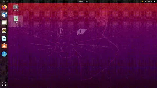

the default process-working.svg file is like this.
and its properties are like this.
There seems to be a trick with svg images, Its a single svg image with different spinners. So I googled and got some 512 x 32 pixels with similar gnome-shell theme and could successfully change the spinner.
Getting/Creating the SVG is going to take much time.. So I used vanilla gnome's spinner and default Yaru's
Yaru's enter image description here
Vanilla GNOME's enter image description here
Edit:
have edited the original process-working.svg file with inkspace like this for testing purpose keeping the original size 512 x 32 px with svg format and tested it.
