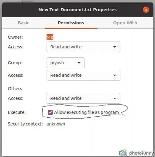

Go to your desktop an right click the text file and click on properties now come to permissions and disable this option which I have shown in the image :- enter image description here
After unchecking it close it and try again. Hope this helps :) .Thankyou.
