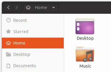

@vanadium has provided an exhaustive explanation of why we can no longer drag and drop to and from the Ubuntu desktop. (+1) I would only like to add that if you open the Desktop folder in Nautilus you can drag and drop anything to and from that and any other folder that is open in a separate Nautilus window. It’s the best workaround that I have found so far.
Nautilus sidebar
