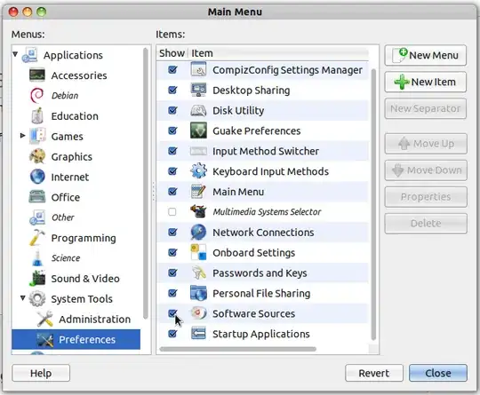

You can do following steps for showing "Software Source" program in Unity search result:
  1. Install "Main Menu" program from software center(package name is "alacarte").
  2. Run "Main Menu" program.
  3. From right panel called "Menus" open "System Tools" node and select "Preference" node.
  4. Check "Software Source" in next pane.
  5. Finish, in next login you will see Unity "Software Source" in search result
