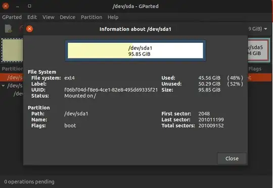

I have an MBR partition which I want to convert to GPT without loosing all my data. Bios is UEFI. I am not an expert of hard disks, so please be patient. I have seen this and this but I cannot understand if I can apply those procedures without erasing all my files, since the partition has only 2048 free sectors before the beginning of data. This is my partition:

Device Boot Start End Sectors Size Id Type /dev/sda1 * 2048 201011199 201009152 95,9G 83 Linux /dev/sda2 201013246 234440703 33427458 16G 5 Extended /dev/sda5 201013248 234440703 33427456 16G 82 Linux swap / Solaris

  2. Your /dev/sda1 starts at sector 2048 so you are good to go.
