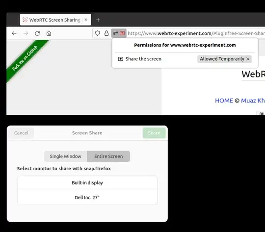

Firefox snap
The default Ubuntu 22.04 firefox (snap) uses wayland by default, and supports WebRTC screensharing (test eg with this WebRTC experiment)
portal in firefox

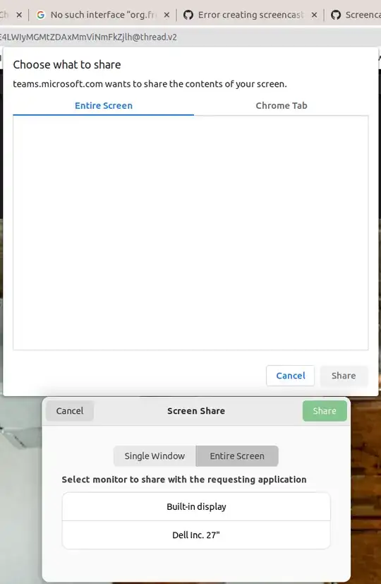

You also need to enable the WebRTC PipeWire support flag (chrome://flags/#enable-webrtc-pipewire-capturer).
[portal in chrome]
It still suffers from the "double" portal issue discussed in WebRTC/Chromium Updates In 2020, but it's usable.

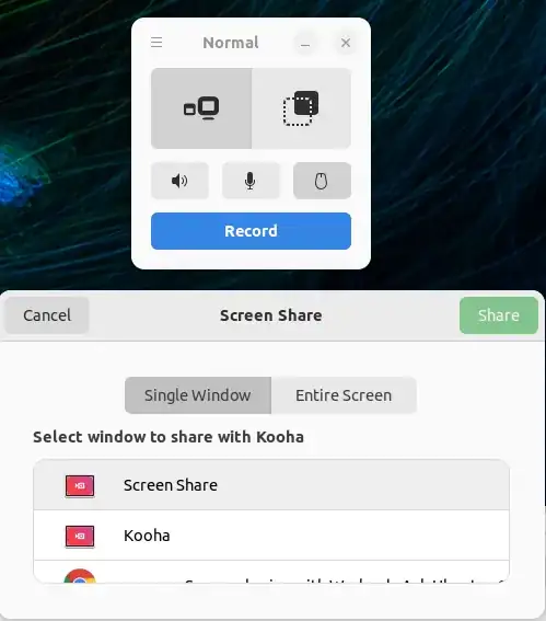

Kooha flatpak (screen recorder)
sudo apt install flatpak
flatpak remote-add --if-not-exists flathub https://flathub.org/repo/flathub.flatpakrepo
flatpak install io.github.seadve.Kooha
flatpak run io.github.seadve.Kooha &
[portal in Kooha]

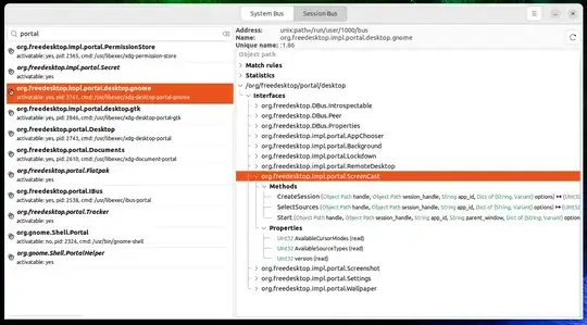

  • tip: run apps from command-line and check output for error messages like Error creating screencast session: GDBus.Error:org.freedesktop.DBus.Error.UnknownMethod: No such interface “org.freedesktop.portal.ScreenCast” on object at path /org/freedesktop/portal/desktop -- which means that you don't have a portal implementation -- e.g. this is the expected dbus setup as seen with d-feet: d-feet If you see org.freedesktop.impl.portal.desktop.gnome has some interfaces but not the ScreenCast one, it can mean a missing pipewire setup, or that xdg-desktop-portal-gnome was not restarted to pick it up.
