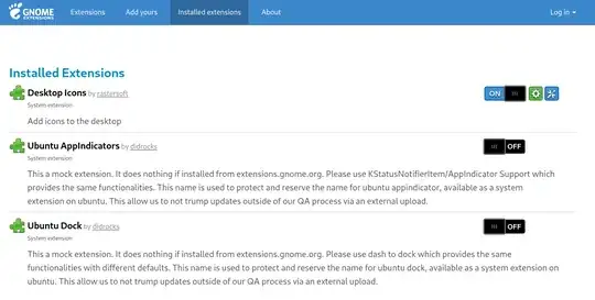

--- another update --- https://extensions.gnome.org/local/
extensions.gnome.org screen shot

Almost all gnome-shell errors are due to faulty gnome-shell extensions.
Good thing is that you don't have many of these extensions.
If you redo my grep, slightly modified, to:
grep -i gnome-shell /var/log/syslog* | grep -i extensions
You'll come up with a lot of hits that contain similar to this snippet:
/usr/share/gnome-shell/extensions/desktop-icons@csoriano
Guess which gnome-shell extension is suspect?
Do the work
So we'll move this extension out of the way and replace it with a substitute. I'll abbreviate my instructions, as you're terminal savvy.
cd /usr/share/gnome-shell
sudo mkdir extensions.HOLD
sudo mv extensions/desktop-icons@csoriano extensions.HOLD/desktop-icons@csoriano.OLD
restart gnome-shell
go to https://extensions.gnome.org/extension/2087/desktop-icons-ng-ding/ and install this extension.
restart gnome-shell
right-click on the Desktop and select "Settings" to set prefs.
Monitor system for gnome-shell errors AFTER the current time:
