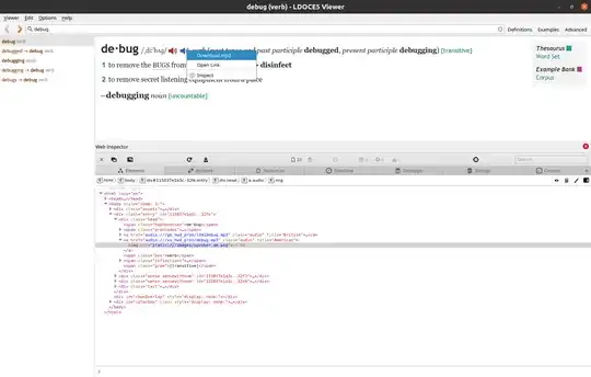

  3. The mp3 file of the sound exists and it can be downloaded (there is a download option in the gui as can be seen in the following screenshot):
I just don't know why the sound is not playing when clicking on the sound button (blue or red icons). Each time I click on one of them, the play method of the GstreamerBackend(Backend) class in soundplayer.py is hit. There is no error and I could confirm that the last line of the method (self._player.set_state(Gst.State.PLAYING)) is also reached. I could not go any further in my investigation of the issue. I appreciate any help to fix this.
