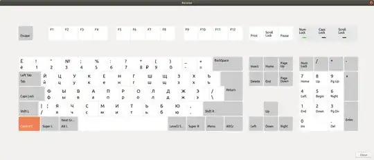

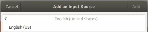

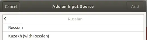

Keyboard layouts chosen:
  1. English (United States) -> English (US) English (United States) -> English (US) Keyboard layout as shown by Ubuntu
  2. Russian -> Russian Russian -> Russian Keyboard layout as shown by Ubuntu

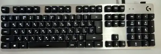

  3. Photo of actual keyboard

Looking closely I see that your selected layout has AltGr where the physical one has CTRL, but also that the selected layout has another key for 3rd level, which on the physical is AltGr. How could that not be a problem? How does that work? When you say Altgr you are referring to what key? (the physical one on which is written CTRL or that on which is written ALTGR? are both acting as ALTGR?)
All this is getting very confusing and — if you expect an answer (and more effort from others) you should clarify basic things like this.
Only after clarifying the above continuing with the rest could make sense.
