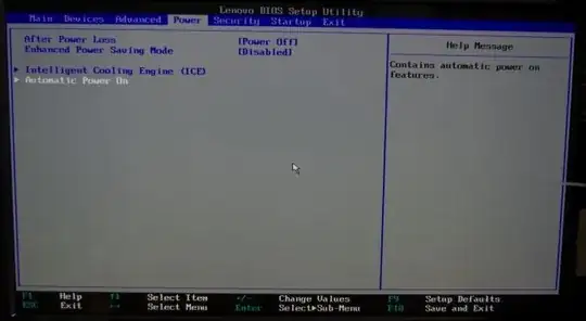

Hypothesis: System (BIOS) has a power savings mode
I've checked the BIOS. There's an Enhanced Power Saving Mode. However, (1) this is about entering power saving mode when it's already Off, not about turning off; and (2) it's Disabled. In Power, most features were about automatic or controlled power on. Nothing else related.

I have a pair of P340Tiny systems acting as web servers for a couple of non-profits in the community and have not run into this particular issue. At first I thought that you might be running the device headless, as doing so may trigger the BIOS on some systems to force a shut down after a certain amount of time with no display. The same sort of “feature” exists on some Lenovo All-in-One’s, shutting the machine off if there has been zero activity from keyboards or mice for 16 hours. However, looking through the user guide at the power features, I do not see any such functionality. I also looked at the Power tab in the BIOS of one of my P340Tinies and didn’t see anything suggesting the machine might shut down on its own either:
Lenovo P300-series BIOS Settings
One thing I can say is that the P340Tiny units I’m running do not exhibit the behaviour you see. They both run Ubuntu Server 20.04.1 and are configured to run until they’re told otherwise. Aside from the very occasional reboot, they’ve been running 24/7.
That said, you had mentioned that you installed the ubuntu-desktop package on your machine for a GUI, and this has me thinking there is something in systemd that is shutting your machine off.

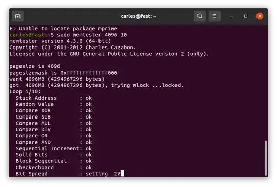

I would recommend to disable overclocking if it's enabled and test memory. Reboot your Server and from the GRUB menu select Perform Memory Test or boot with an Ubuntu Live CD and select Memory Test. If it hangs in there you have your answer.
You can stress your system with stress-ng. It will test the memory too. Other tools to test the memory without rebooting:
sudo apt-get install memtester
This will allocate 4GB of RAM and run the test 10 times.
sudo memtester 4096 10
If it is a server with ECC Memory, memory errors will be logged and you can check IPMI. Server can have a remove GUI tool to access them called ILO (HP)/iDRAC (Dell), I think in Lenovo is called TSM (ThinkServer System Manager).

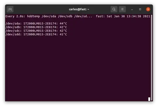

To read the temperature of the drives and the CPU easily you can use:
sudo apt install hddtemp lm-sensors
Then use:
sudo hddtemp /dev/sda
# Outputs
/dev/sda: ST2000LM015-2E8174: 44°C
And
sensors
coretemp-isa-0000
Adapter: ISA adapter
Package id 0:  +48.0°C  (high = +95.0°C, crit = +105.0°C)
Core 0:        +46.0°C  (high = +95.0°C, crit = +105.0°C)
Core 1:        +48.0°C  (high = +95.0°C, crit = +105.0°C)
Core 2:        +46.0°C  (high = +95.0°C, crit = +105.0°C)
Core 3:        +46.0°C  (high = +95.0°C, crit = +105.0°C)
Core 4:        +45.0°C  (high = +95.0°C, crit = +105.0°C)
Core 5:        +46.0°C  (high = +95.0°C, crit = +105.0°C)
If you want to continuously watch it you can do:
sudo watch hddtemp /dev/sda
Which will refresh the value every 2 seconds by default.
You can specify more than one drive:
sudo watch hddtemp /dev/sda /dev/sdb /dev/sdc /dev/sdd

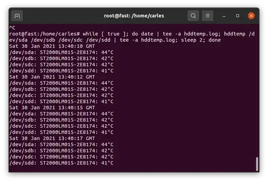

hddtemp
Probably the best is to run sensors capturing in background so when it powers off again you know what was the last temperature reading.
I wrote this small script for you:
while [ true ]; do date | tee -a hddtemp.log; hddtemp /dev/sda /dev/sdb /dev/sdc /dev/sdd | tee -a hddtemp.log; sleep 2; done
Loop printing and keeping in log the temperature
You can do the same for CPU.
I recommend you to run in background inside a screen session.
To execute screen just type:
screen
And from there your command. To exit screen without interrupting press: CTRL + A, and D
To interrupt the script press CTRL + C
