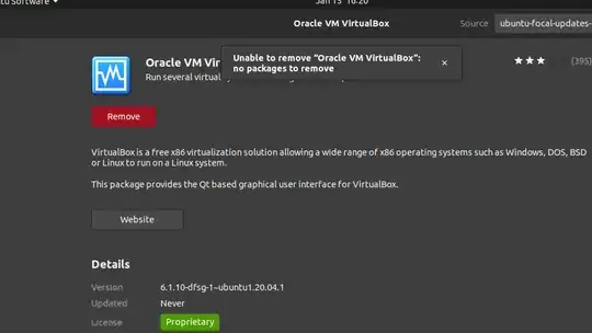

I have tried removing it via Ubuntu Software center directly directly, but it says Unable to remove Virtualbox as it doesn't exist enter image description here
I tried to run sudo apt-get remove virtualbox-* which didn't work either. I installed Vbox by downloading its .deb file from the official site. Double clicking on the .deb file opened Ubuntu Software app from where I installed Vbox The following is the output of the remove cmd

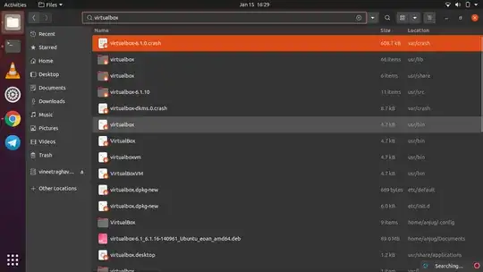

VirtualBox is currently installed in my system because I can run the app by tapping on its icon. My doubt is that it's installed brokenly in other than the default directory so the standard uninstalltion is unable to detect it. Here is the search result view of "Virtualbox" in the root directory enter image description here
