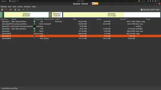

  2. If you want to change the partitions/space after the installation, you cannot do it if you use the disk/Ubuntu (ext4 partitions cannot be resized when used). You need to boot from a live cd/USB and click 'try ubuntu' and from there, open up the GParted program (If its not there you can install it):
    sudo apt update
    sudo apt install gparted
And from Gparted you can change the partition sizing.
Here you can see my Gparted screenshot. My computer is dual boot btw: enter image description here
