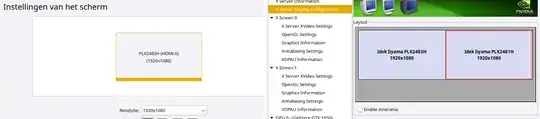

I have a two monitor screen connected, but since the update of the Nvidia 460 I can only use one monitor, and the other monitor is black. When I reset it to Nouveau both screens are there. What can I do to get this back?
xrandr
Screen 0: minimum 8 x 8, current 1920 x 1080, maximum 32767 x 32767
DP-0 disconnected (normal left inverted right x axis y axis)
DP-1 disconnected (normal left inverted right x axis y axis)
HDMI-0 connected primary 1920x1080+0+0 (normal left inverted right x axis y axis) 531mm x 299mm
   1920x1080     60.00*+  59.94    50.00
   1680x1050     59.95
   1600x1200     60.00
   1440x900      59.89
   1280x1024     60.02
   1280x960      60.00
   1280x720      59.94    50.00
   1152x720      60.00
   1024x768      60.00
   800x600       60.32    56.25
   720x576       50.00
   720x480       59.94
   640x480       59.94    59.93
nvidia-settings: X configuration file generated by nvidia-settings
nvidia-settings: version 440.82

I had a similar issue with my three screen setup. Surprisingly, the solution was to change the refresh frequency of one of the screens. The only way I could get all 3 screens to work was to set one of them to 59.xx Hz instead of 60Hz. I'm not sure why this happens, and the logs didn't seem to help.
