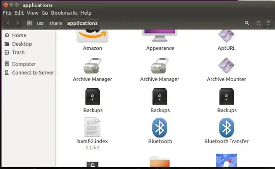

If you are interested in having it in the Unity launcher that way, there's a pretty easy way to do so, at least in Ubuntu 16.04.
First, open Nautilus as root:
gksu nautilus /usr/share/applications

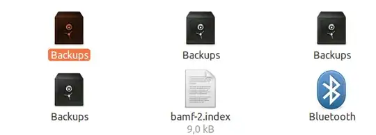

You are likely to find three Backup app launchers there:
Locate the one which command is plainly deja-dup-preferences:
Now, with that one selected, use Ctrl+C and Ctrl+V to duplicate it.

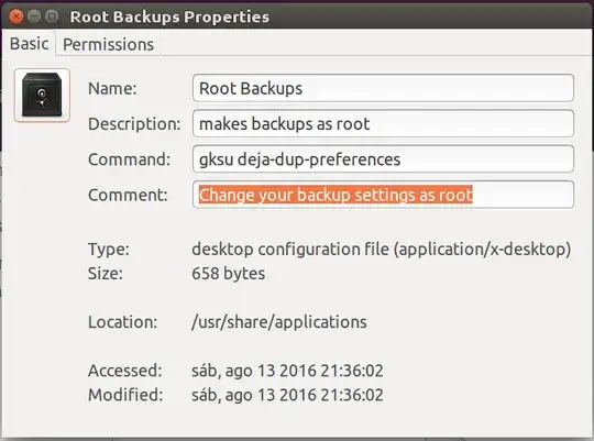

Right click on the icon that's highlighted and open Properties. They should be the same that you have seen before. Change them so they look like these:
Once you've made the changes, close that window and drag that icon you just have edited into the Unity Launcher so it's locked there.
That's it. Now every time you click on that launcher, it will request your root password and run deja dup as root instead of your current user.
