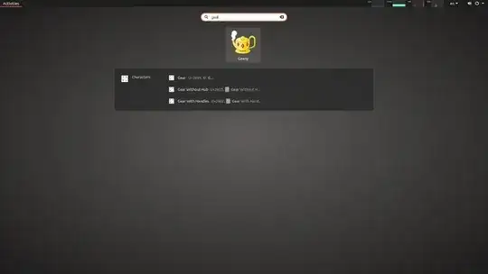

When I press the super key, or activate the hot corner, the "overview" screen comes up, where I can search for apps, settings, documents, and more:
screenshot of Gnome dash
Problem / Challenge:
I find this overlay too dark compared to how my desktop normally looks; each time I have to use it, I find it has an intrusive impact on the experience, and it's a tiring exercise for my eyes to adjust.
I would like to make this overlay somewhat lighter / brighter.
