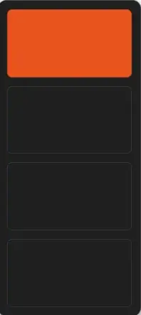

When switching workspaces the popup thing is really annoying.
workspace switcher popup
Is it possible to disable it?

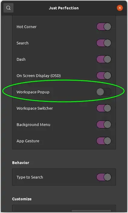

Another extension you can use is Just Perfection. In the extension's settings disable Workspace Popup.
Just Perfection extension settings

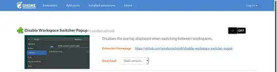

This can be achieved by installing one of the following GNOME extensions:
Both work with Ubuntu 20.04.
