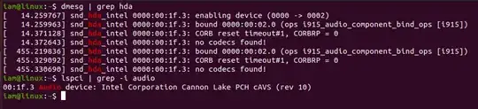

here is output of lspci:

So, I have two systems on my HDD: OpenSUSE and Ubuntu, after Ubuntu installation I have no sound in both systems, and they have the same errors. How can I fix sound? Also, I use EFI.
More info:

And the text of error from logs:
Failed to load module "module-alsa-card" (argument: "device_id="0" name="pci-0000_00_1f.3" card_name="alsa_card.pci-0000_00_1f.3" namereg_fail=false tsched=yes fixed_latency_range=no ignore_dB=no deferred_volume=yes use_ucm=yes avoid_resampling=no card_properties="module-udev-detect.discovered=1""): initialization failed.
Output of lspci -nnk | grep -A2 Audio
00:1f.3 Audio device [0403]: Intel Corporation Cannon Lake PCH cAVS [8086:a348] (rev 10)
    DeviceName: Onboard - Sound
    Subsystem: Lenovo Cannon Lake PCH cAVS [17aa:313d]
