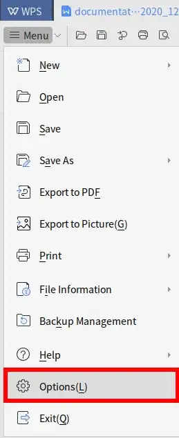

  2. Once the document is loaded, go to Menu -> Options
WPS Menu -> Options

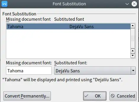

  1. Click on "Font Substitution"
Wait until the new window is loaded. This may take a while (30 sec / 1 min)
  1. The "Font Substitution" window should appear. On the left you find the missing fonts, on the right the fonts that have been used as a substitute. Take notice on what fonts you miss. In the following example, we miss only one font, "Tahoma"
  1. Close WPS. Go on the web and download the fonts that you miss. Copy the missing fonts in a directory in fontconfig search path (for instance, /usr/share/fonts/)

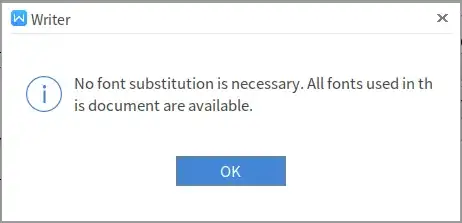

  3. Re-open the file. This time WPS Office should open it very rapidly.
    You can check that you miss no other fonts. Repeating 2 and 3 should return you the following window:
