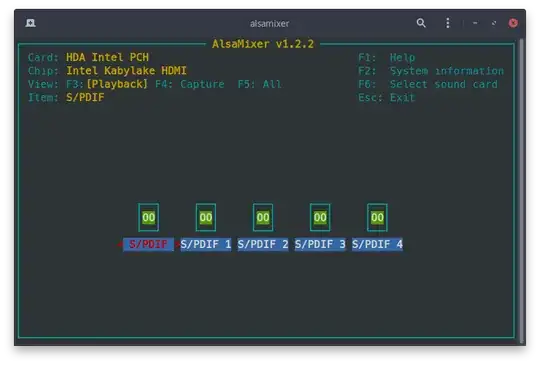

the output of alsamixer is:

I don't even know if it's related to the problem or not, but after trying any way to solve the problem, none of them worked, but after force shutdown, the problem was fixed and it's working properly now
UPDATE March 2022:
This issue happened to me again, I was watching a course and suddenly my laptop rebooted and after that, just dummy output showed to me and there is no sound.
Solved: I purge all PulseAudio by sudo apt purge pulseaudio* and hard shutdown and installed it again and hard shutdown, weird! but it worked.
