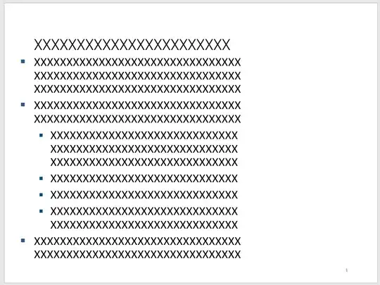

I have reported a LibreOffice Impress bug here. In that bug, the text of a slide went beyond the page margin
Although it looked fine in Microsoft PowerPoint
Now I cannot reproduce the bug anymore. LibreOffice Impress, the same version used to report the bug and also provided by Canonical, seems to display it correctly.
