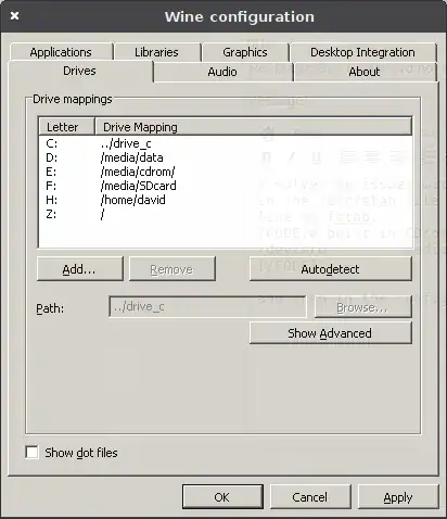

Another option for you would be to run dvdshrink through wine. I have been able to do this rather easily, the only thing extra needed is to list your cdrom in your fstab file and then also add the drive in winecfg as well.
Start by running this command:
sudo mkdir -v /media/cdrom
This will make the directory where your cdrom will be mounted. Then run this command to open fstab with gedit as root.
gksudo gedit /etc/fstab
Here's the fstab line needed to mount the cdrom, simply copy and paste it to the end of your fstab file:
# built in CDrom
/dev/sr0    /media/cdrom    auto    ro,noauto,user,exec 0 0
Run this command:
sudo mount -a
Then run:
winecfg
Here's a picture of where to add drives in winecfg just click the drives tab, then the autodetect button. Then apply, and OK.
winecfg, drives tab

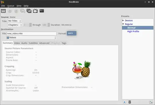

HandBrake
HandBrake is really good, and this is the tool I recommend.
The download is available at https://handbrake.fr
Better yet, there is a PPA at https://launchpad.net/~stebbins/+archive/handbrake-releases/
Although the PPA for the most recent release (version 9.9) is for Raring, it works just fine in 14.04. You can add the HandBrake repository for Raring and install HandBrake in Ubuntu 14.04 as follows:
echo "deb http://ppa.launchpad.net/stebbins/handbrake-releases/ubuntu raring main" | sudo tee -a /etc/apt/sources.list.d/handbrake.list
echo "# deb-src http://ppa.launchpad.net/stebbins/handbrake-releases/ubuntu raring main" | sudo tee -a /etc/apt/sources.list.d/handbrake.list
apt-key adv --keyserver keyserver.ubuntu.com --recv-keys 816950D8
sudo apt-get update
sudo apt-get install handbrake-gtk

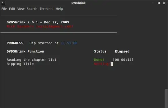

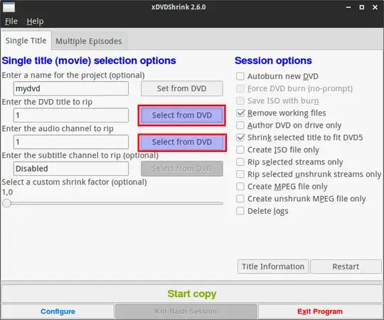

xDVDShrink (also .deb) - Does not work on all dvd sources (encrypted etc). The dvds tested above were not even accessed, so I tested with 4.7 dvd movie without protection.
No support for subtitles is seems (also mentioned here), one single video title and one single audio channel selectable it looks.

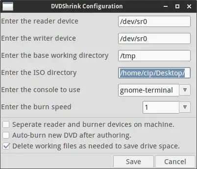

I had made also these settings:
that were not followed. No .iso file was to be found on the desktop or elsewhere. But nor the /tmp files had been deleted as set, so I was able to test those. The full dvd files were found in /tmp/mydvd/BUILD/, but they can be played with VLC and SMPlayer just as ordinary video files, without the original dvd structure of menus. The most severe problem is the absence of subtitles (funny in my case as I was testing with a Japanese movie.)
Therefore: xDVDShrink is NOT an alternative.

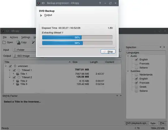

I have left aside for a while k9copy, which many have recommended in the past, and which, as already stated under this question, is considered the real DVDShrink alternative for Ubuntu.
As the initial project is now inactive, there is a new developer that supports a k9copy-reloaded version - HERE.
I have installed without any problems the latest deb posted there - the Jessie version - in a Kubuntu 15.04-development branch. It has added only 13 new dependencies.
In Ubuntu Unity and any other non-KDE desktops it will come with a lot more KDE dependencies. But that is the problem with many other KDE applications that at some point may be needed for a specific purpose. If your purpose is to backup DVS-s the way DVDShrink does in Windows, then having some KDE dependencies is not such a bad deal.
k9copy-reloaded looks like a real alternative and for now the only answer to the question.

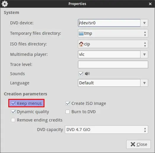

K9copy is said(...) to be the best DVD Shrink alternative. The original developer ceased developing K9copy. K9copy-Reloaded is the continuation of K9copy by a new developer. Information:
IMHO it would be valuable to include a review of K9copy-Reloaded in @cipricus great post, I recommend using the Trusty/Utopic or Jessie packages from tomtomtom site. Beware that K9copy is Qt based and is best installed in a KDE environment, other environments possibly need to pull in a lot of dependencies.

For a while k9copy, which many have recommended in the past, and which, as already stated under this question, is considered the real DVDShrink alternative for Ubuntu, was not supported. But, as the initial project is now inactive, there is a new developer that supports a k9copy-reloaded version. Deb packages can be found HERE. To add a PPA - look HERE:
sudo add-apt-repository ppa:tomtomtom/k9copy
sudo apt-get update
sudo apt-get install k9copy
k9copy looks like a real alternative and for now the only answer to the question.
