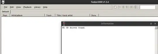

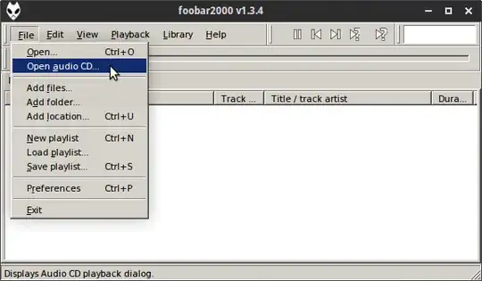

I have installed Foobar2000 in Wine and it has no access to the CD.

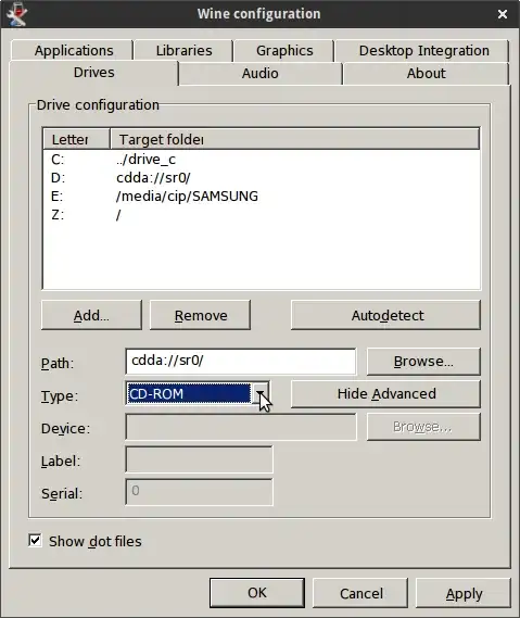

In Wine configuration I added the cd drive.
But it doesn't work.

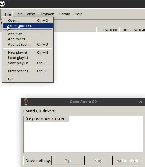

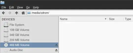

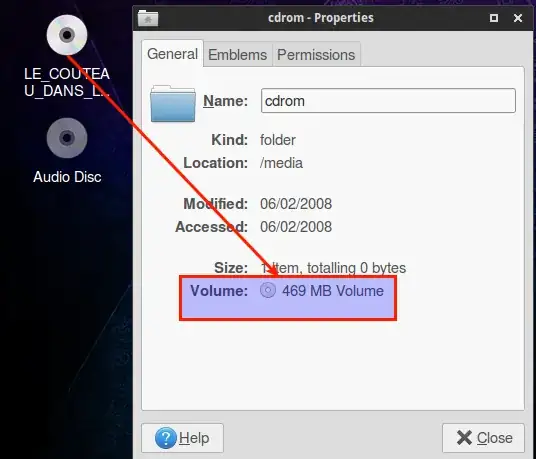

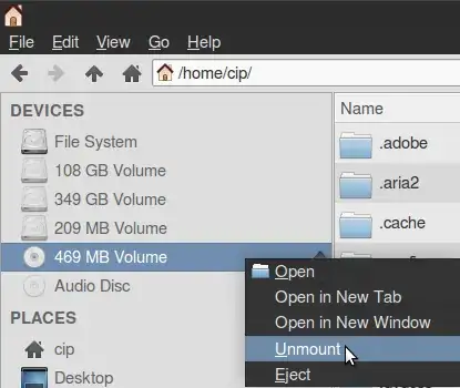

Excepting in one situation: if inserting a dvd and then replacing the dvd with the audio cd without unmounting first, the audio cd will be then seen foobar2000, while in Thunar file manager and on the desktop the audio is displayed twice.
This stands as a workaround for now.

  • why cdda://sr0/ is not a good mounting point to be set in Wine configs?
  • while media/cdrom can be set and works for dvds - why doesn't it work for audio cds?

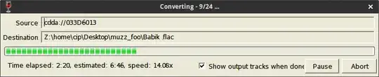

I remember I already did this in the past trying to confirm that Foobar2000 works in Wine: I was able to rip cds then! without the dvd mounting trick.
An answer below says that the workaround (described above and also posted by me as an answer) is a Thunar bug that makes the cd accessible by (giving the impression of) mounting it first.
But if a bug can do it, there should be a 'proper' way to do it. (Not trying to mount the cd if that is impossible, but making it accessible otherwise.)
Even if audio cds cannot be mounted, they are still accessible in Ubuntu players without being mounted: how to achive this in Foobar2000?
EDIT: Considering the bug that made me happy, it has nothing to do with Thunar: it was already posted on launchpad: Disks are not unmounted when physical eject button is used. Also, related here. Found about it in this discussion here.
Why is cdda://sr0/ not a good mounting point to be set in Wine configs?
CDDA is not a filesystem. It's a specific protocol for reading and writing data to/from CD drives. Think of CDDA like an http:// for CD drives. You can't use HTTP for Wine because it's not a local part of a file system. CDDA, likewise, isn't part of your local filesystem. Both are protocols for getting data from remote sources.
WINE is a compatibility layer. It can not and will not be able to directly interface with everything that Linux offers. It can interface with some things, but drives are problematic. You need to add the drive to the Wine config so it knows where to look. This is why Wine can't see /dev/sdc unless you tell it to. And, you cannot mount CD drives, so.... You might be able to request Wine's developers to add Audio CD support. Maybe you'll get it. That will make everyone happy.

  • It's not a workaround for a bug in Thunar. It is a bug in Thunar GVFS. See Sergey's answer for why this is. It's caused by Thunar not knowing the difference between the two GVFS drives.

I will re-post as a workaround what I found and posted in the question.
I read on various pages that the audio cd cannot be mounted, also here, that it should not be, or that there is no need to mount it - also here.
Anyway, Foobar2000 for whatever reason cannot see the normal way when an audio-cd is inserted.
There is this weird workaround that by a sort of bug in Thunar can make the audio cd be seen as a dvd and mounted.
  • Insert a dvd movie in the cdrom drive, wait for it to mount or mount it.
  • Open Foobar2000, open cd
  • Without unmounting the dvd, replace it with the audio cd.
  • 'Open' the cd.
Rip will work too.
But while this is done through what appears to be a bug that makes the cd accessible as if it were a dvd, the real answer should be how to access the cdrom in foobar2000 in the way the native applications do (if cds are never mounted, then, without mounting them!)
