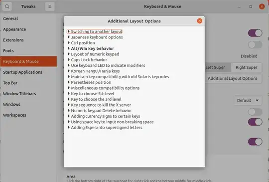

I am altering the keyboard configuration in Ubuntu 20.10 via
gnome-tweaks
and then, in Keyboard and Mouse/Additional Layout Options I set Alt/Win key behavior to "ctrl is mapped to Win and the usual ctrl keys", since I'm using a the mac magic keyboard.
This choice however is reset each time I lock the screen, so I have to keep resetting it.
Is there a way to fix this?

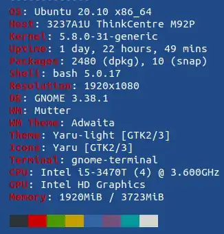

System details:
