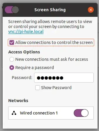

I keep Screen Sharing turned on on this machine I use for a Pi-hole server. However, every time I reboot, Screen Sharing won't work, and I need to go to the physical PC, disable SC, and then reenable it. Then it is working again. My Screen Sharing settings:
Ubuntu Screen Sharing dialog
Ideas for how to fix this, so I don't need to reset SC after every reboot?
