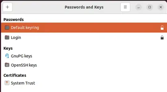

  1. Open "Passwords and Keys" app on the desktop. Password and Keys App

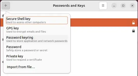

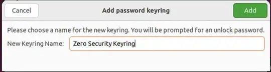

  2. Create a new "Password Keyring" using the "+" icon. Create a new Password Keyring
  3. Name the new keyring "Zero Security Keyring" or something that reminds you it will be un-encrypted. Leave the password blank so that the keychain is unencrypted. You will be warned that you are creating an unencrypted keychain.
    Name the keyring so that you will remember it is unencrypted

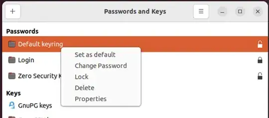

  4. Right-click on the new keyring and choose "set as default" Set the new keyring as the default

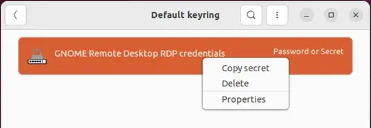

  5. Click on the old "Default" keyring and delete "GNOME Remote Desktop RDP Credentials" Delete the old RDP password from the "Default keyring"

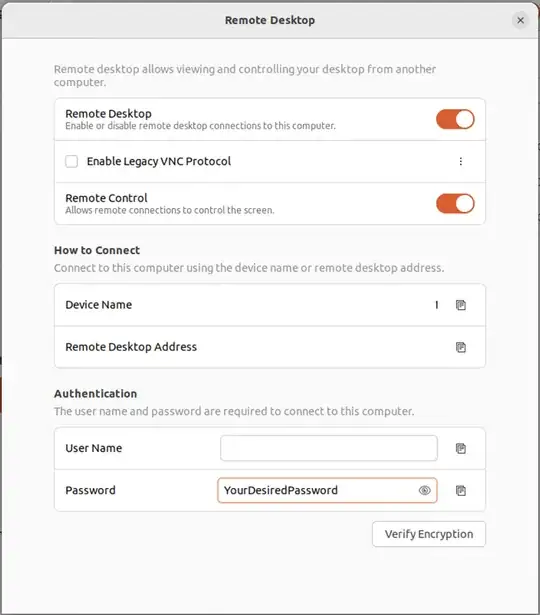

  6. Open settings and set a new RDP password set a new RDP password

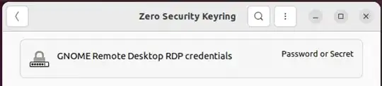

  7. Check that the password was stored under the "Zero Security Keyring" Check that the RDP password was stored in the new keychain

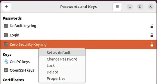

  8. Right click on "Default" keyring and choose "set as default" Remember to set "Default keyring" as the default
