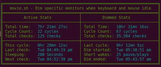

The second solution is close to your needs but has no logging. When you are watching movies this script dims the other two monitors and records inactivity time in X11:
