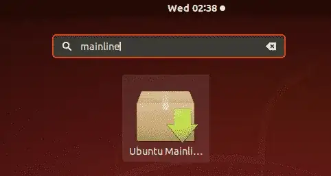

  4. Launch the mainline tool from the Ubuntu search bar as follows:

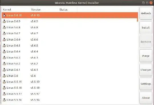

  5. When the Mainline tool is launched, you will see the following installer window with a list of new and available kernel versions. You may install a new version by selecting the version from the list and clicking the Install button on the bar to the right.

Now, reboot your system and verify the new kernel version:
uname -r
