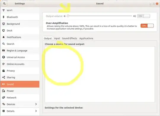

2/3: In my Sound settings, the "Output volume" is greyed out at the top, and there are no output devices shown:

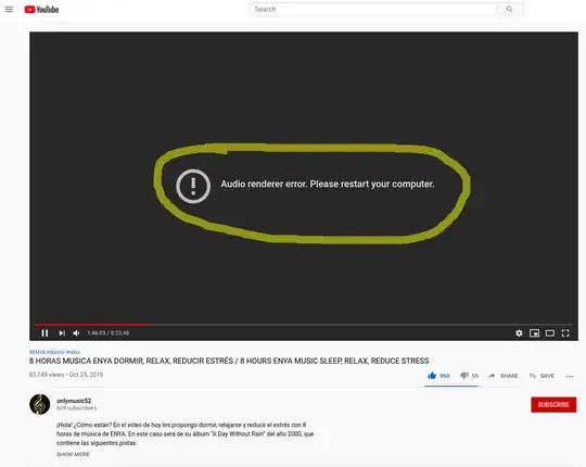

3/3: On YouTube, it says:
Audio renderer error. Please restart your computer.

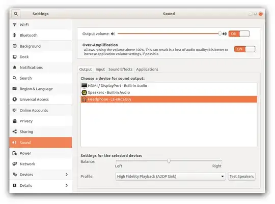

1/3: the speaker and bluetooth icons ARE there:
2/3: in my Sound settings, the volume slider does work, and the output devices are shown!:

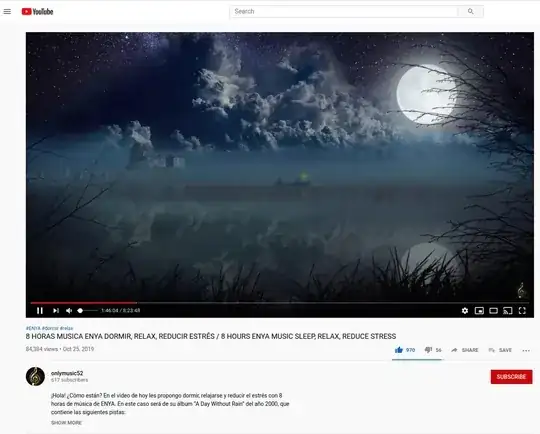

3/3: the YouTube video works just fine:
