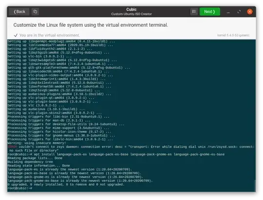

  2. Launch Cubic
    Navigate to the Terminal page.
  3. Add the necessary repositories
    add-apt-repository --yes main
    add-apt-repository --yes restricted
    add-apt-repository --yes universe
    add-apt-repository --yes multiverse
    Remove your existing packages.
    apt autoremove --purge totem rhythmbox
    You should probably leave the English language packages and let them automatically be removed by the installer after installation of the OS (see step 8 below).
  4. Upgrade packages
    apt upgrade
  5. Add your new packages
    apt install vlc audacious mc rar unrar
  6. Install your language packages
    (You will find these are already installed in the Live ISO).
    apt install language-pack-es language-pack-es-base language-pack-gnome-es language-pack-gnome-es-base
    Cubic Terminal Page

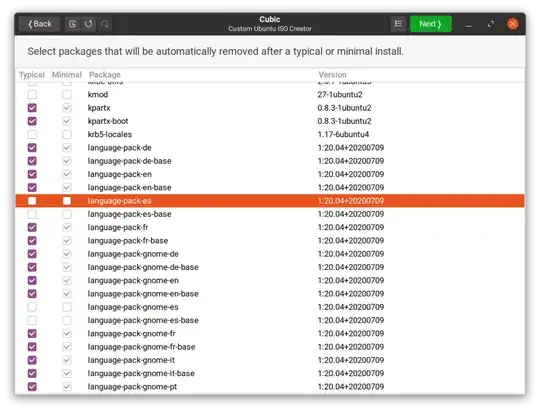

  8. Tell the Ubiquity installer to not remove your language packages
    Navigate to the Packages page.
    Click (anywhere) on the list, and begin typing the word "language" to search for packages that begin with this word.
    Uncheck the following four packages:
    • language-pack-es
    • language-pack-es-base
    • language-pack-gnome-es
    • language-pack-gnome-es-base
    This will ensure that the installer does not remove your language packages. This is not strictly necessary, since we will select your language and locale in the preseed below (step 9), but it is a good measure nevertheless.
    You will also notice that the English language packages are flagged (check-marked) to be automatically removed by the installer after installation of your customized OS (if English is not selected as your default language).

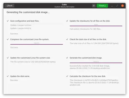

  10. Generate your customized ISO
    Finally, navigate to Cubic's Generate page to create your customized ISO.
