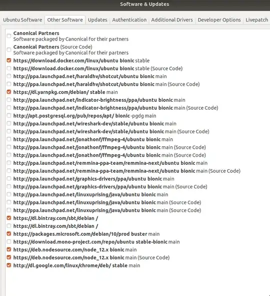

I did this and removed all of them: https://help.ubuntu.com/community/Repositories/Ubuntu#Removing_.26_Disabling_Repositories But I still get this:
Could not calculate the upgrade

It says broken packages so I went through this tutorial to try to fix them: https://www.maketecheasier.com/fix-broken-packages-ubuntu/ Actually I just noticed all the PPAs I removed are back:
updates GUI

It looks like it is Python related but I've been told to hold off on removing Python 2.
  1. Disable PPA's in Softwares Source (software-properties-gtk) and Enable all official channels (main, universe, multiverse)
  2. Run update
    sudo apt update
    sudo apt upgrade
    sudo apt dist-upgrade
    sudo apt auto-remove
  3. Check obsolete packages, for safe purge, if you have doubts update/ask question here.
    aptitude search '~o'
  4. Compare previous list to:
    aptitude search '~S (!~O|~o)  ~i'
    Then check all additional packages with:
    apt-cache policy <packagesname>...
    if any of them is available from official repository, then you need to force downgrade them, use:
    sudo apt install <packagename>=<version>...
    (This step could be made easier with scripting)
  5. If you are sure about previous list, packages are extra and not required by system. Simulate to check again
    aptitude -s -y remove '~o'
  6. Then run for real
    sudo aptitude remove '~o'
Go for Ubuntu upgrade again.
