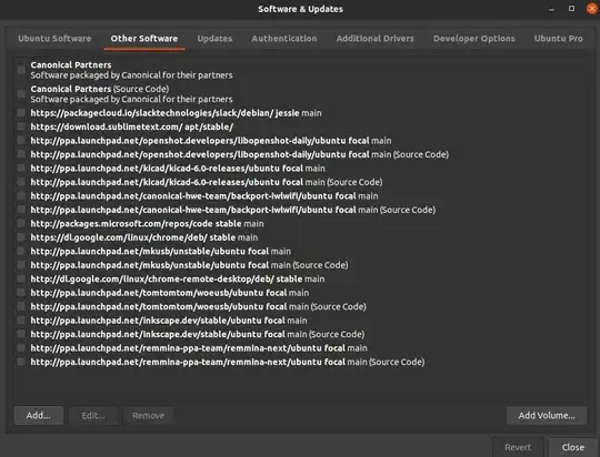

I tried with the GUI to deactivate the ppa links but it also didn't work

I know I put a bunch of stuff in this machine, any advice on going back to "original state" to allow for upgrade?
Other than running ppa-purge one by one and trying to upgrade, is there any alternative?
This is my current setup
lsb_release -a
No LSB modules are available.
Distributor ID: Ubuntu
Description:    Ubuntu 20.04.5 LTS
Release:    20.04
Codename:   focal
It took a while and some frustration but:
  1. I went for ppa-purge remmina as my comment says
  2. Install went fine with a few Y/N questions
After reboot, I was trapped in the Log in loop.
I checked all the posts about it and my permissions looked fine, I didn't have lightdm and installing it only created problems (e.g., I was booting into terminal instead of UI). I uninstalled lightdm and continued checking for options.
Ever since I installed chrome-remote-desktop, my Ubuntu experience has been a nightmare of asking permissions for doing everything (log in, files, mount a USB flashdrive, ...). As suggested here the login loop can be related to chrome-remote-desktop. After:
sudo apt-get purge chrome-remote-desktop
I could finally log into the desktop version of jammy.
Because I had deactivated all ppa, some of that software was not installed in the new ubuntu release (e.g., inkscape). Rstudio was also not installed
Software that was installed and not functioning also needed
sudo apt-get --fix-broken install
