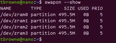

I am running a Jetson Nano with Jetpack 4.4 which (Ubuntu 18.04), by default, has 4x495 Meg ZRAM partitions for swap space. The problem is that for a data science project I need MORE RAM than the 4gig installed on the Jetson (and whatever I get from compressed ZRAM - not much). So I'd like to make an 8gb swap file instead of the ZRAM swap.
How do I disable the ZRAM swap altogether so that I can create a swap file?
I've tried
sudo apt remove --purge zram-config
sudo dpkg --purge zrawmswap-enabler
sudo dpkg --purge zram-config
sudo service zramswap stop
But none of it works. ZRAM swap is still enabled on reboot: enter image description here
Alternatively can I just create a disk swap file and expect it to replace ZRAM?

With zram you are having swap in RAM and compressed. Whenever your system swaps it will be doing it very fast, as is RAM.
You don't need to stop the zram to replace with another swap. You can just add more swap, and let the system handle it.
If you want to change the config ratio of zram edit: /etc/systemd/nvzramconfig.sh

Update 2020-11-04: In JetPack-4.4 nvzramconfig is a Systemd Service, so in /etc/systemd/system you have a file called nvzramconfig.service
# Copyright (c) 2019, NVIDIA CORPORATION.  All rights reserved.
[Unit] Description=ZRAM configuration ; Everything depends on the NVIDIA per-boot script After=nv.service ; TPC power gating must be enabled before anything touching gpu After=nvpmodel.service
[Service] Type=simple ExecStart=/etc/systemd/nvzramconfig.sh
[Install] WantedBy=multi-user.target
You can prevent completely this Service from starting by disabling it:
sudo systemctl disable nvzramconfig
That's the preferred way to do it. But if for whatever reason you don't want to disable the service the not so nice option is to just comment every line in the file /etc/systemd/nvzramconfig.sh like this:
