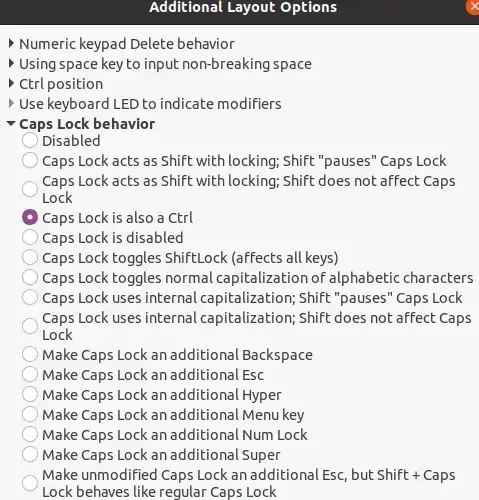

I have caps-lock key remapped to control, which usually works fine, but after some uptime and one/more suspend/awake cycles* this mapping breaks, and caps-lock reverts back to the default behavior -- i.e. turning on the led and capitalizing whatever I type. (Even though the Tweaks UI still shows it as being mapped to Ctrl -- see picture below.)
Tweaks UI

Remark2: removing and readding the mapping (or rebooting) solves the problem, but it would be nice to find a more permanent solution.
