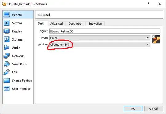

For anyone getting this issue in a VirtualBox VM, make sure you have the VM version set to Ubuntu (64-bit) and not Ubuntu (32-bit) (or vice-versa if you're using a 32-bit .iso).
Picture of VM version field in a VirtualBox settings dialog
