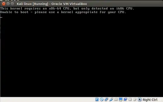

I upgraded Ubuntu 16.04 to Ubuntu 17.04. Now I installed VirtualBox and am trying to make a Kali Linux virtual machine, but it is showing me this message:
This kernel requires an x86-64 CPU, but only detected an i686 CPU.
Unable to boot - Please use a kernel appropriate for your CPU.
I am running Dell Optiplex 745 with 3GB Ram.
VirtualBox screenshot

That message means your CPU is 32-bit, but the Kali image you are using is 64-bit. Use the 32-bit Kali image instead.
