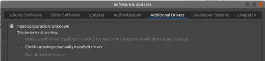

My Aspire 5 has an Intel wifi 6 AX201 wifi card, that just doesn't work. I seen lots of older posts advising to install the 5.3 kernel, but as I have 18.04 LTS with 5.4 kernel...going backwards doesn't seem helpful, especially when 5.4 has support for my graphics card.

And this is what I see under "Software & Updates".. (no ability to change driver selection)
Any advice?
UPDATE I just followed the instructions found here to install the IntelĀ® Wi-Fi 6 AX201 160MHz driver and it again didn't work, even after reboot. (same results as above). Baffled..

nightwatch
  • 805
  • 23
  • 51
Of course, the problem was Windows, the problem is always Windows...
"Shutting down" doesn't really mean "shutting down" to Microsoft.
I happen to notice that Wi-Fi would fail after I was booting Ubuntu from a previous Windows session... But Wifi would load properly if I was rebooting from a previous Ubuntu session.
Well, the "splinter in my toe" has been that with Windows 10, even though you shut down the computer, it actually stays on with minimal power and annoyingly keeps control of the wifi car as part of its "fast boot" functionality.
This means each time that I was booting into Ubuntu following a windows session the Intel Wifi card would fail because it was already in use by the Windows 10 partition.
Symptoms other may face with this same problem:
1.) Aforementioned, WIFI only fails after a previous Windows session on a dual-boot machine
2.) Your firmware is completely up-to-date from manufacturer
3.) Switching to older kernels doesn't resolve the wifi connectivity problem
4.) After loading -without- wifi, you are unable to manually load the driver via command line
SOLUTION If you are experiencing these symptoms you should:
1.) Boot in Windows 10
2.) go into settings > power > advanced options > Select: Choose what power button does > uncheck fast boot (fast startup)
3.) Re-boot and enjoy your microsoft-interference-free wifi ;-)
Gotta give credit to this threat, that stop me from pulling hair out..
