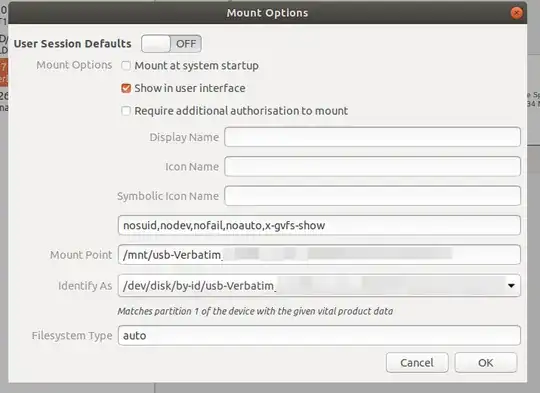

Given that specific USB devices are causing the long boot times and you want to keep them plugged in, you could try disabling automounting during boot. There are two ways you could do this: gnome-disk-utility and manually editing fstab. That second method is for the experienced users only.
For a beginner, use the gnome-disk-utility
  1. Make sure the USB devices are connected.
  2. Open the Disks application from the dash.
  3. Select the disk (in the left pane) and then the partition (in the right pane) that you DO NOT want to mount at startup.
  4. Click on the cogwheel for Additional Partition Options and select Edit Mount Options.
  5. Ensure Mount at system startup at the top is disabled.
Edit Mount Options menu
  1. Click OK and reboot.
See answers to this question (on enabling automount) for further information.
