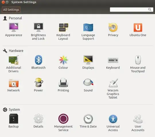

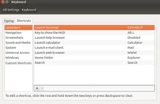

Go to System SettingsKeyboardShortcuts tab → Map Keys here's some screenshots to make it as easy to follow as possible:
Click on this icon
