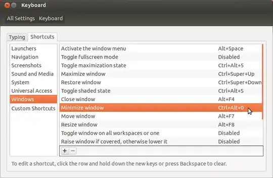

Launch keyboard:
Shortcuts, windows, minimize window, click at the right of the bar as indicated
It will toggle to new accelerator. Just press CTL + ALT + 0 not the numpad zero.
Do note that the numpad zero shortcut will no longer work after you do this. Shortcuts now make a distinction between numpad numbers and across the top numbers, although it isn't noted as 'numpad0' in the keyboard wizard.

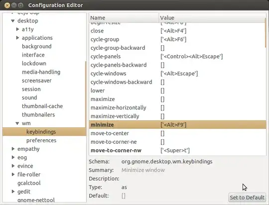

If you wish to continue to use Alt+F9 then you can. For unity* just set to it in system settings > keyboard > shortcuts > windows as seen in the screenshot in aking1012's answer
For gnome-shell you need to set in gsettings, either graphically in dconf-editor as in screen or thru gsettings
gsettings set org.gnome.desktop.wm.keybindings minimize "['<Alt>F9']"
