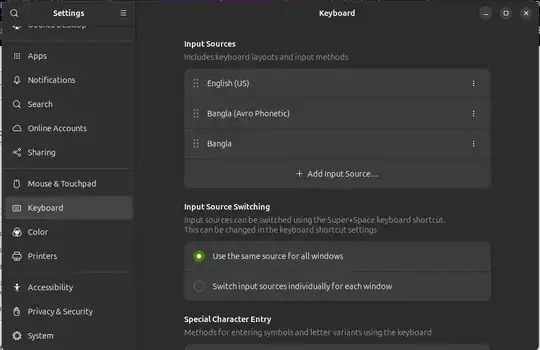

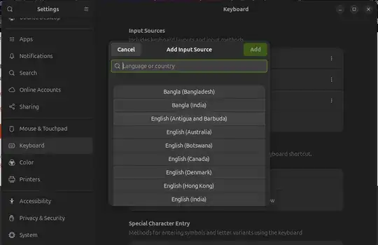

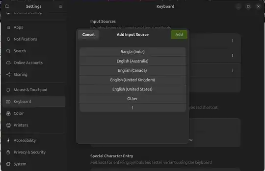

Go to Settings > Keyboard (Settings > Region & Language in 20.04)

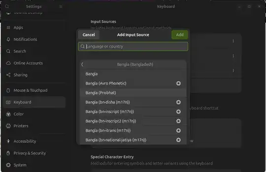

In Input Sources click +
Click Bangla or Bangla (Bangladesh)
Finally select Bangla (Avro Phonetic)
Now it should work just fine.

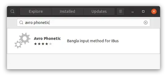

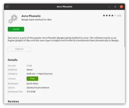

  • Open Ubuntu Software
  • Search Avro Phonetic in Ubuntu Software search bar avro phonetic in ubuntu software
  • Click install install Avro Phonetic
  • Restart the machine or Logout and then login again

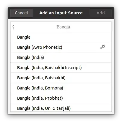

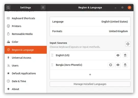

  • Open Settings > Region & Language
  • Click on the + (plus) icon in Input Sources
  • Search for Bangla and then click on Bangla (Avro Phonetic) Add Bangla Avro Phonetic
  • The Avro Phonetic will be added to the Input Sources Avro phonetic in Input Sources

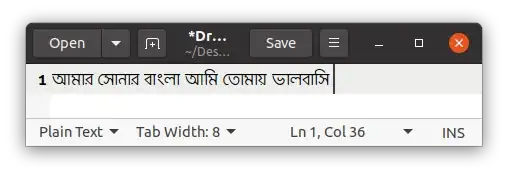

  • Now you will get a dropdown for selecting bn for Bangla language in top bar right corner
  • You can switch between different Input Source using win + space keyboard shortcut Write using Bangla

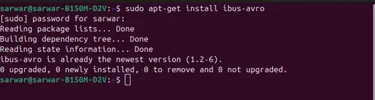

sudo apt install ibus-avro
Terminal:
terminal screenshot
