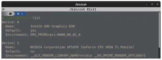

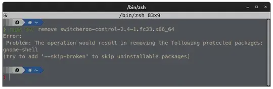

Which confirms it, more intuitive proof (I am a fedora user): screenshot of terminal

this is the environment variables set by switchroot-control (in my case). enter image description here
