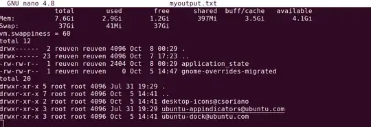

Edit: @heynnema Both are Microsoft and wireless. Here the output you asked for in the order stated:
myOutPut

Your swap is excessive at 37G. Let's change from a 37G swap partition, to a 4G /swapfile.
In the terminal...
sudo swapoff -a           # turn off swap
To edit /etc/fstab, use sudo -H gedit /etc/fstab or sudo pico /etc/fstab
Comment out the following line:
UUID=9cd65f59-278f-416d-aede-189ce6ff4086 none   swap    sw   0   0
Save the edit and quit the editor.
Note: Incorrect use of the dd command can cause data loss. Suggest copy/paste.
sudo dd if=/dev/zero of=/swapfile bs=1M count=4096
sudo chmod 600 /swapfile # set proper file protections sudo mkswap /swapfile # init /swapfile sudo swapon /swapfile # turn on swap free -h # confirm 8G RAM and 4G swap
Confirm this /swapfile line at the end of /etc/fstab... and confirm no other “swap” lines...
To edit, use sudo -H gedit /etc/fstab or sudo pico /etc/fstab
/swapfile  none  swap  sw  0  0
Save the file and quit the editor.
reboot                    # reboot and verify operation
Note: The 37G swap partition (/dev/sda3) is no longer used, may be deleted, and the unallocated space may be added back to your Ubuntu partition using gparted.
